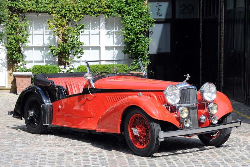

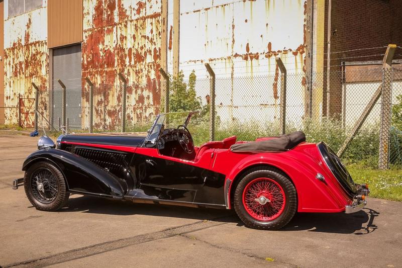

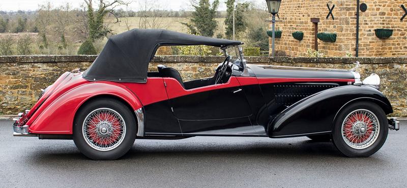

I think different colour wings front and back would look great! Here are three combinations on the 4.3 Alvis, two with different but matching wheelcolours, one with contrasting silver wheels: Decisions, decisions!

That's the one I was thinking of but got the colours the wrong way round.

Oh - just realised the second photo IS the one I was thinking of.

I think different colour wings front and back would look great! Here are three combinations on the 4.3 Alvis, two with different but matching wheelcolours, one with contrasting silver wheels: Decisions, decisions! I like the 3rd design but would like to see the black on the bonnet carried over to the boot, and down to the rear wings. however I'd prefer burgundy to the red. Each to his own" Brian 8227
