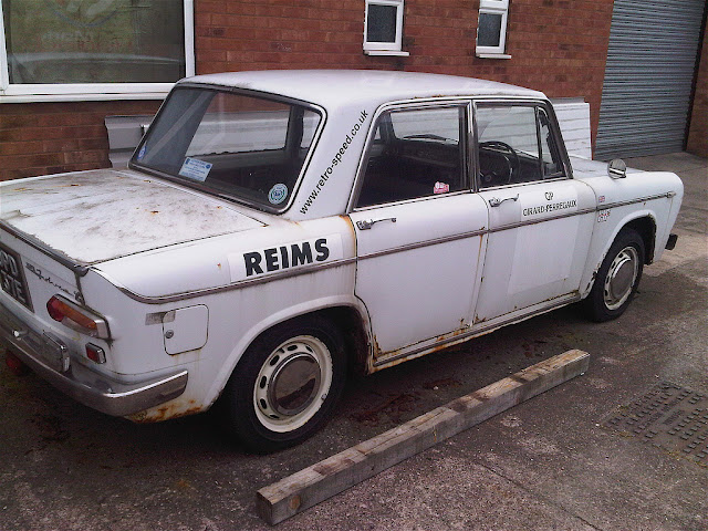

Yes, the Newberry/Ferrari car previously known to you and as described by Chris above is the result of my trawl for something to bring home on the empty trailer. I don't recall seeing it on eBay at any stage in recent years but that may be as I was not particularly looking for one.
I am very pleased with it and am making it my project for Fulvia 2013 but you would be sorry to see its condition now. I will post a few more pictures of my own but you can see it in this set by Lee Proudfoot (current pics at bottom of page 2):
http://www.flickr.com/photos/80688018@N00/sets/72157606371734891/with/2349496211/
As the later pictures show, the bottom 6 inches are now so bad you would wonder how it was capable of road use even as recently as 2008. I can only assume that its 10-years spent in the Newberry collection following its import from Cyprus via Greece (as I understand from Lee) extended its natural life but that it began to deteriorate in real time once again when Mr Ferrari put it into regular use. However it is very straight, complete and mostly original apart from the bigger engine and the electrical modifications made for rally use. The exterior trim is all particularly good.
No doubt I will be in touch about one thing and another but don't expect a perfect or even faithful restoration like your own car as I have some pretty radical ideas for it but I think it will be a good candidate for Fulvia 2013 whatever happens and at least it will live to see another day.
Current needs include a front bumper and the black bits of the dashboard - I know you re-fashioned some of yours but I would be optimistic of sourcing these on the continent. The main  parts seem to be ambidextrous as regards LHD and RHD? Can't really think of what else it might need - I presume Bill Lewis is the man for sills and arches?

Sorry to see poor old OPD in the condition she is now in, the underbonnet fire Lee had certainly couldn't have helped with doing other necessary jobs, and I suspect that she has never had any major work to the lower body up to now.

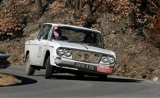

Nice photo of Peter on the Historic Monte, don't think I've ever had "Fay" leaning that much even on the Fiat Test Track at La Mandria!

We were travelling downhill on snow when the track suddenly went left. I went straight on and smote a low wall with my eyes closed. luckily only the bumper took impact, we didn't stop as were were running late. After the next control I discovered the missing quarter bumper. Later when parked up on the Quay in Monte Carlo a young man who has been spectating on the Col handed us back the missing part. I may still have it if it helps? I also have a selection of Sedan parts.

Towing in the UK is still presenting me with problems as it seems my car dolly is, strictly speaking, permitted only for use in the recovery of broken down cars and not for routine car transport. Hiring a full car transporter at daily rates to work around this restriction is a bit of an added cost and a logistical pain.
As it happens, I may end up making a bespoke 2C transporter trailer myself in this case since I am thinking of reducing the car to a rolling shell before I transport it to the UK in case it ends up staying there to have work done. But I could go further to facilitate the body restoration and make it a bare shell for which I could make a simple 2-wheel trailer. With a bare shell on a 2 wheel trailer I would be prepared to argue the toss with any road traffic officer that it is, strictly speaking, no longer a a towed car and that it certainly has no wheels on the ground!

Alan,
It isn't in fact a 2c it's a Normale, and while they are the purest Fulvia Berlina they are not exactly a ball of fire, but if you can live with the performance they are very nice.
The Normale although it had 1091cc engine only turned out 58 BHP @ 5800rpm, 7.8:1 compression Ratio,
Max Torque was 8.4 Kgfm @4000 rpm, and had a single twin choke downdraught (Compound) Carburettor. It is being sold with the twin chike solexes but while this will improve the performance it will still not be up to the same level as a 2c.
2c has 71bhp @ 6000rpm 9:1 Compression Ratio and has 2 x  Twin Solex C32 PHH horizontal carburettors.
At the same time the gear ratios were changed and the subframe mounting points revised.
Although "La Lancia" doesn't say so, I've always been under the impression that there were changes to the rear seat to give a better seating position at the same time, and that there were also changes to the instruments.
An easy way to tell is that Normale was the only Fulvia Berlina to have the front and rear overriders and there wasn't a 2c badge on the rear panel, it also seems to be minus the left front indicator and the rear carpet, although rubber mats were standard spec originally.
Surprised no photos of the engine compartment or the boot?
I think that Normale was actually slower than the Appia that it had replaced.
The 2c was bought in to answer the demand for extra power, and the 2c superseded the normale as the standard Fulvia Berlina.

Hi Brian
You are of course quite right. I forgot about the particular meaning of "2C" and its lineage almost as soon as I had learned them and was simply using the term to describe a car that looked broadly like mine/ours.
You can have some "fun" classifying mine when it emerges with a 1600 engine, 5-speed box, alloy wheels, girling brakes, highback seats, lower suspension, Fulvia Sport bonnet stripes and a sound system. At least thats the plan. I've been told I have to keep the colour white though.
Do you know if Fulvia sedans ever came with tinted glass, as in, the light green tint seen on continental models of some cars, including Lancias such as the 2000?
Alan
